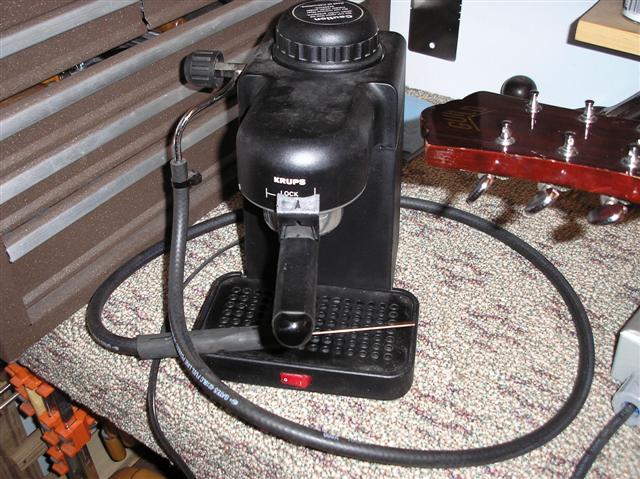

PostPosted: Tue Oct 17, 2006 8:41 am
Here's what I use.I found it at a thrift shop here for 8 bucks. It does the job. Stew-Mac sells a hose and needle for it.
